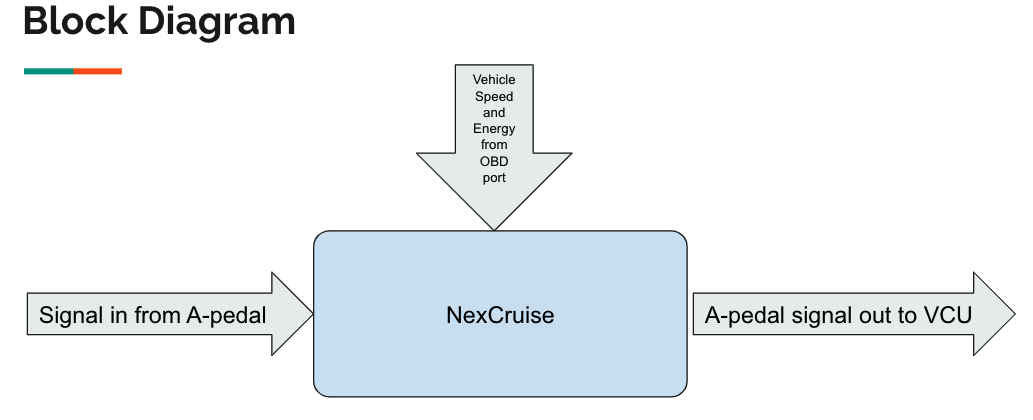

InfoNexCruise is an ECU which connects to the Car's accelerator pedal. NexCruise Modulates the Accelerator Pedal signal to use features like Cruise Control, Dial Driving, Cruise Resume, Speed limiter, Eco Mode and Sports Mode.
Working of NexCruise
It works by taking the Input signal from the Car's Accelerator pedal and then it modulated the signal according to the feature user want to use (eg. Like cruise control) then this modulated signal is sent to the Car's VCU which runs the car in that desire feature (as in cruising), so that's how NexCruise works in the car.
