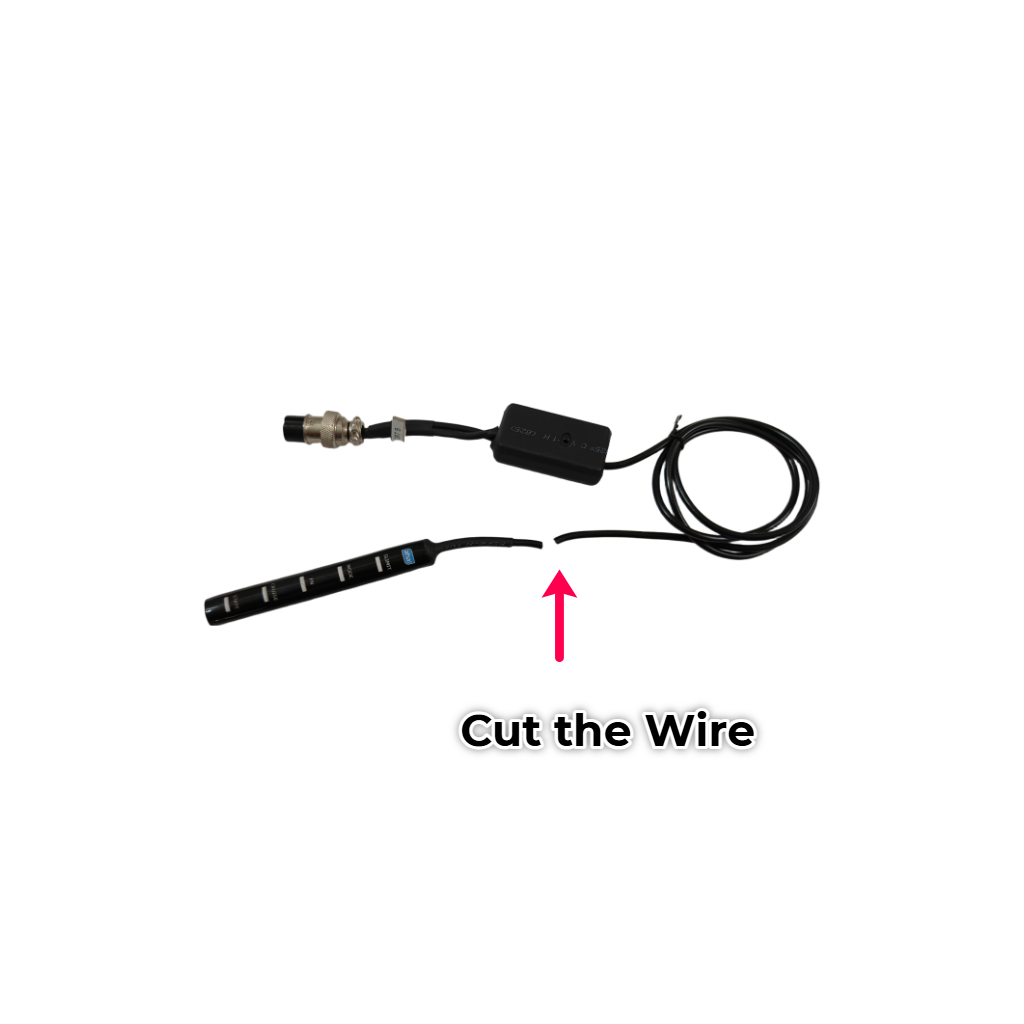

first remove the old LED display strip from the NexCruise unit.
Cut the old LED Wire
Carefully cut the old LED display wire near the connector.

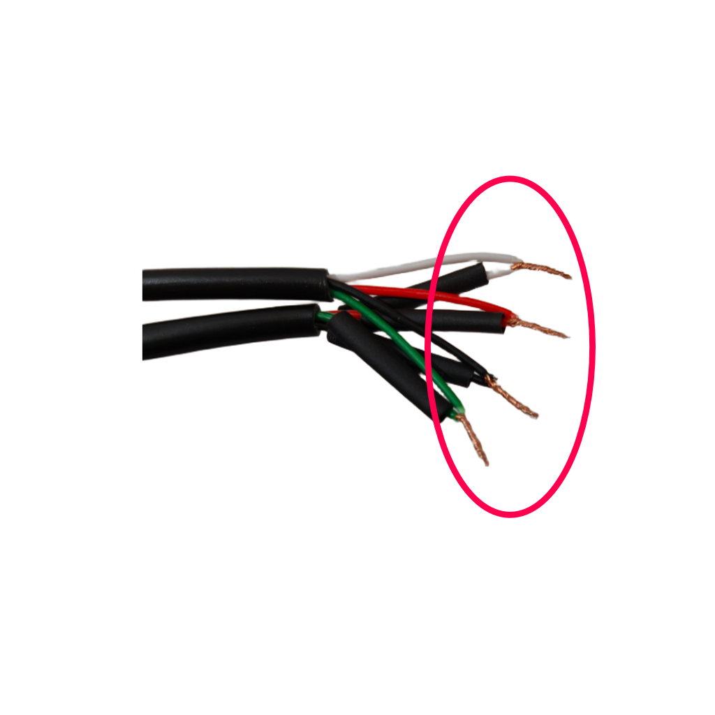

Strip the wire ends
Use a wire stripper (or scissors carefully) to strip about 1 cm of insulation from each wire.

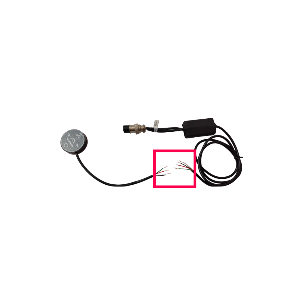

Match the wire colors
✅ Red ➝ Red
✅ Black ➝ Black
✅ White ➝ White
✅ Green ➝ Green

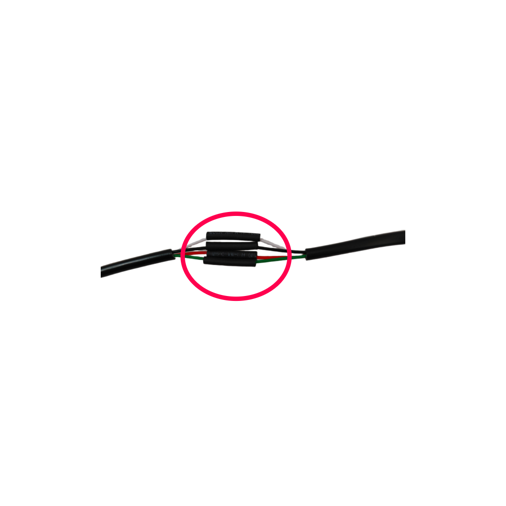

Slide and shrink the heat shrink tubes (we provide them!)
  1. Slide the heat shrink tubes (provided in the kit) over the wires before joining.
  2. After connecting and twisting each matching wire, slide the heat shrink over the joint.
  3. Use a lighter or heat gun to gently shrink the tube over the connection.

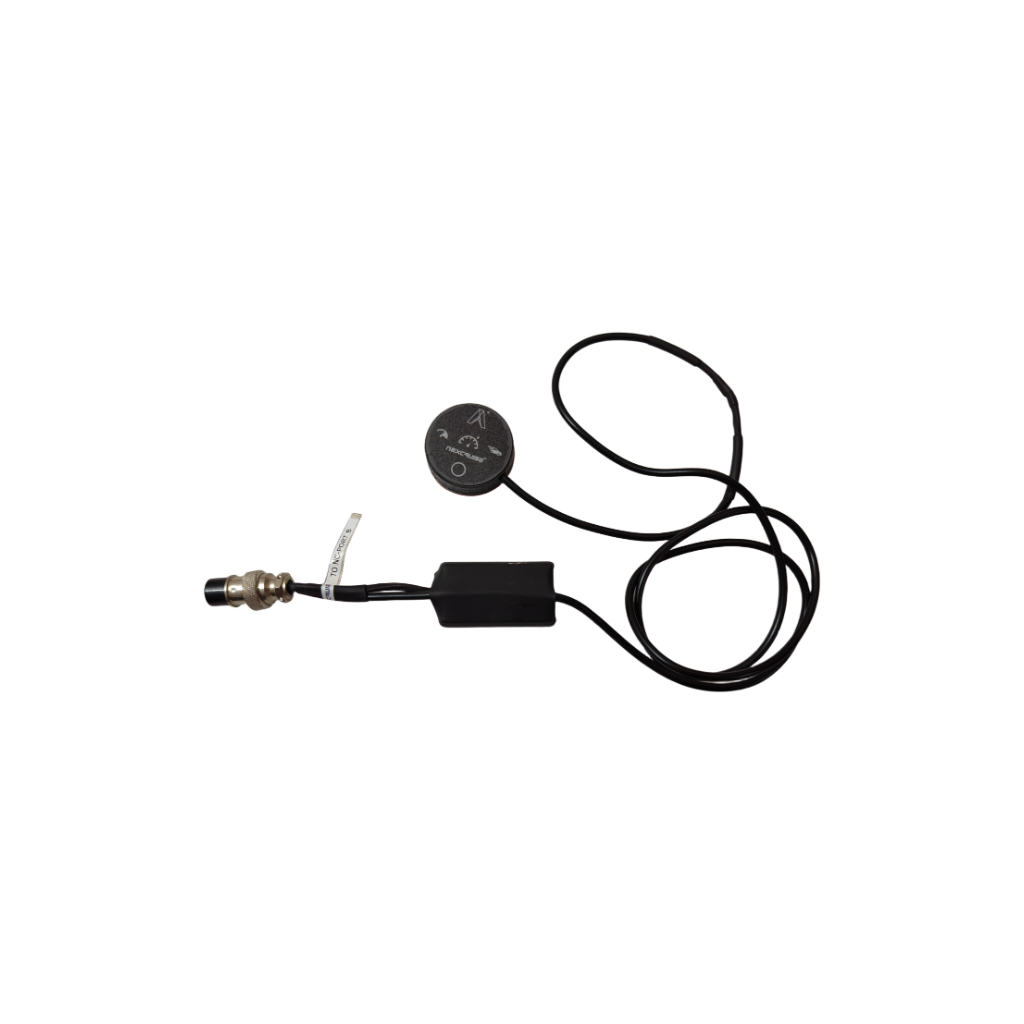

🎉 Congratulations!
Your NexCruise LED Display is updated and ready to use.
