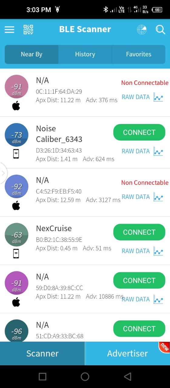

Signal strength of NexCruise signal is very low
Diagnosis
1) Install BLE Scanner app (this is a third party app)
2) Launch BLE scanner and ensure that you see NexCruise in the BT devices list.
3) Ensure that the signal strength of NexCruise is 50dBm or lower. (Here, a larger number means low signal strength and a lower number means better signal strength)
Solution
If the signal strength is low, move the mobile near the NexCruise device till you see a strong signal. After that, without moving the mobile, close the BLE scanner app, and lauch NC app and connect.
