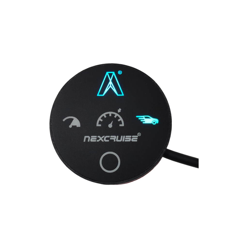

πŸ”΅blue
The car ignition is on, but it's not moving.
Car speed from 0 to 5 kmph.

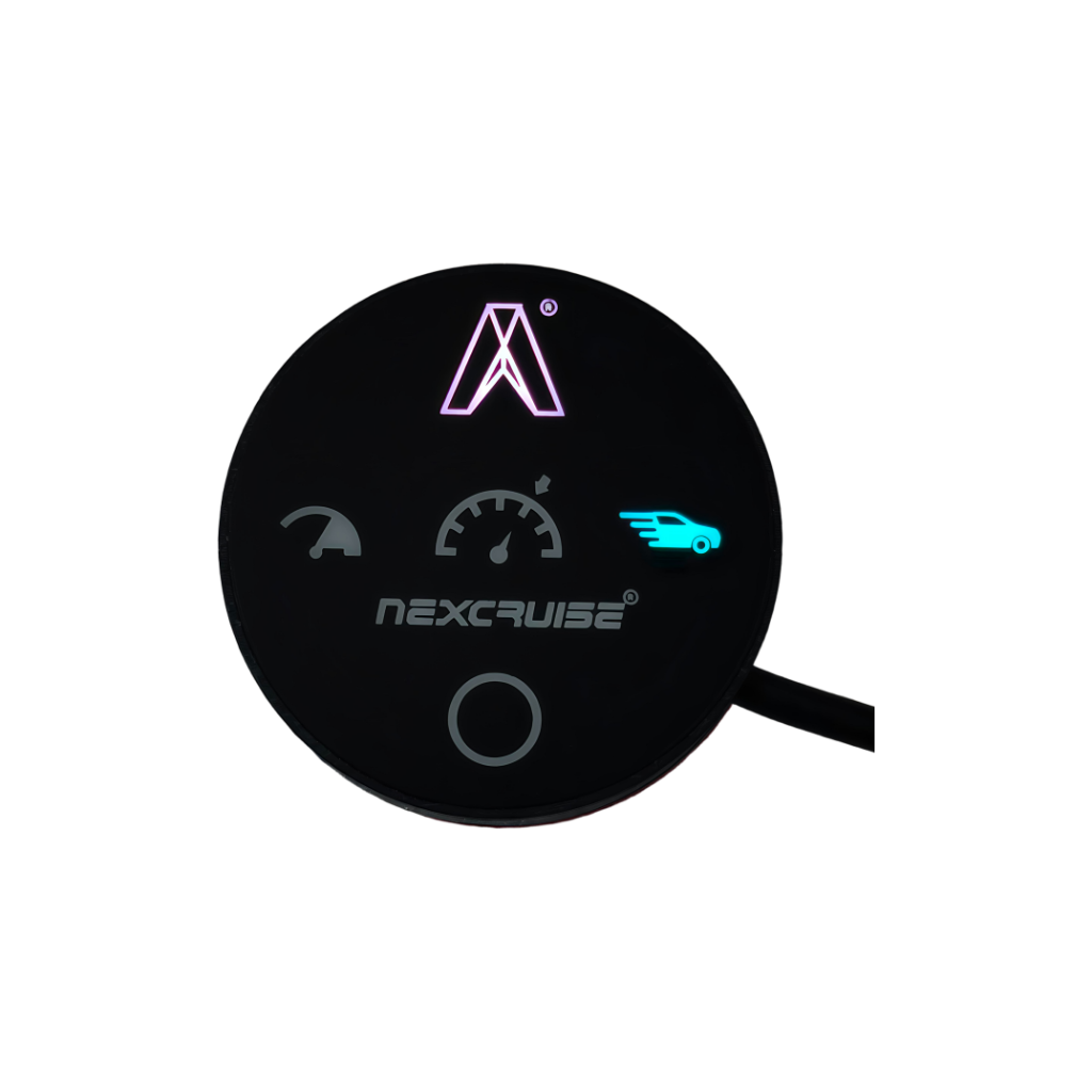

βšͺWhiteWhen the speed of the car will be 5 Kmph or more.
this means that now we can use the feature of  Nexcruise.But Cruise cannot be engaged.

πŸ”΅Blue  (State LED)
By turning on the car's ignition, we will see that the blue light in the State LED bar comes on, indicating the current state and mode.
βšͺ White (State LED)
When the speed of the car will be 5 Kmph or more, then the state light will change from blue to white color (this means that now we can use the feature of  Nexcruise).

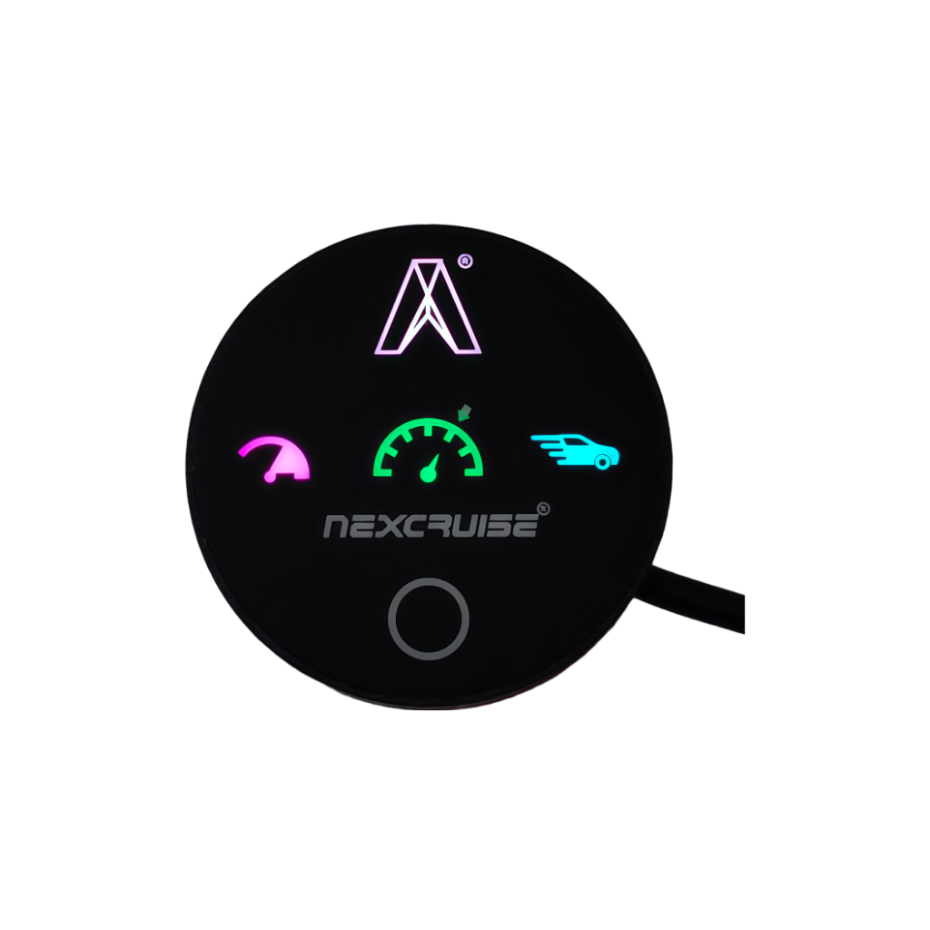

Green on
The cruise will be engaged.
Green off
The cruise will be disengaged.
the cruise is to be disengaged, then press the center button of the dial 0r the Brake pedal.
Engaging Cruise
🟒 Green  (Cruise  LED)
Reach the speed you want to maintain. Press the center button on the dial. The Cruise LED will turn Green, and cruise control will be engaged

🟣Magenta on
The Speed limit will be engaged.
⚫Magenta off
The Speed limit will be disengaged.
Engage Speed Limit
🟣 Magenta  (SLimit LED)
To engage the Speed limit feature, press the Speed limit button on the dial, as soon as the Speed limit button is pressed, the Magenta color light of the speed limit turns on in the SLIMIT LED.(We can set the speed limit in the CAR.OS app)

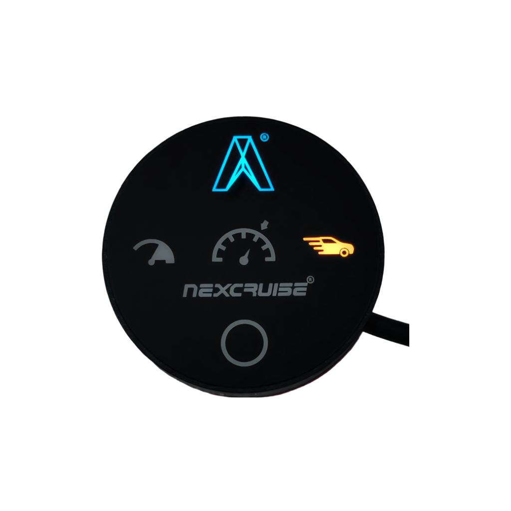

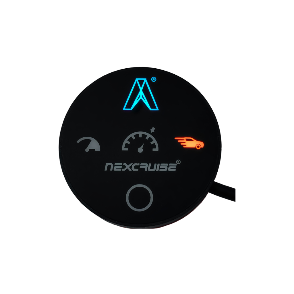

🟠OrangeSports mode will be engaged.

Sports Mode
🟠 Orange ( Mode LED)
To engage Sports mode, we have to click on the Sports mode button of the dial, as soon as we click on the Sports mode button, the Orange light  will come on in the Mode LED .
