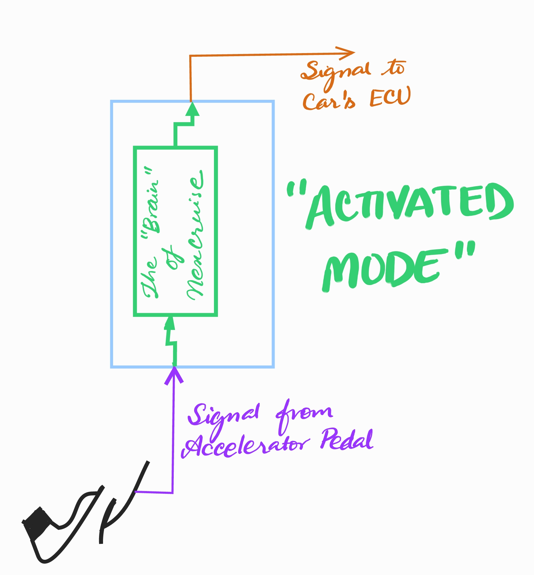

When the NexCruise is configured to do its job by modifying the Accelerator pedal signal that goes to your car, we call it an "activated" device.

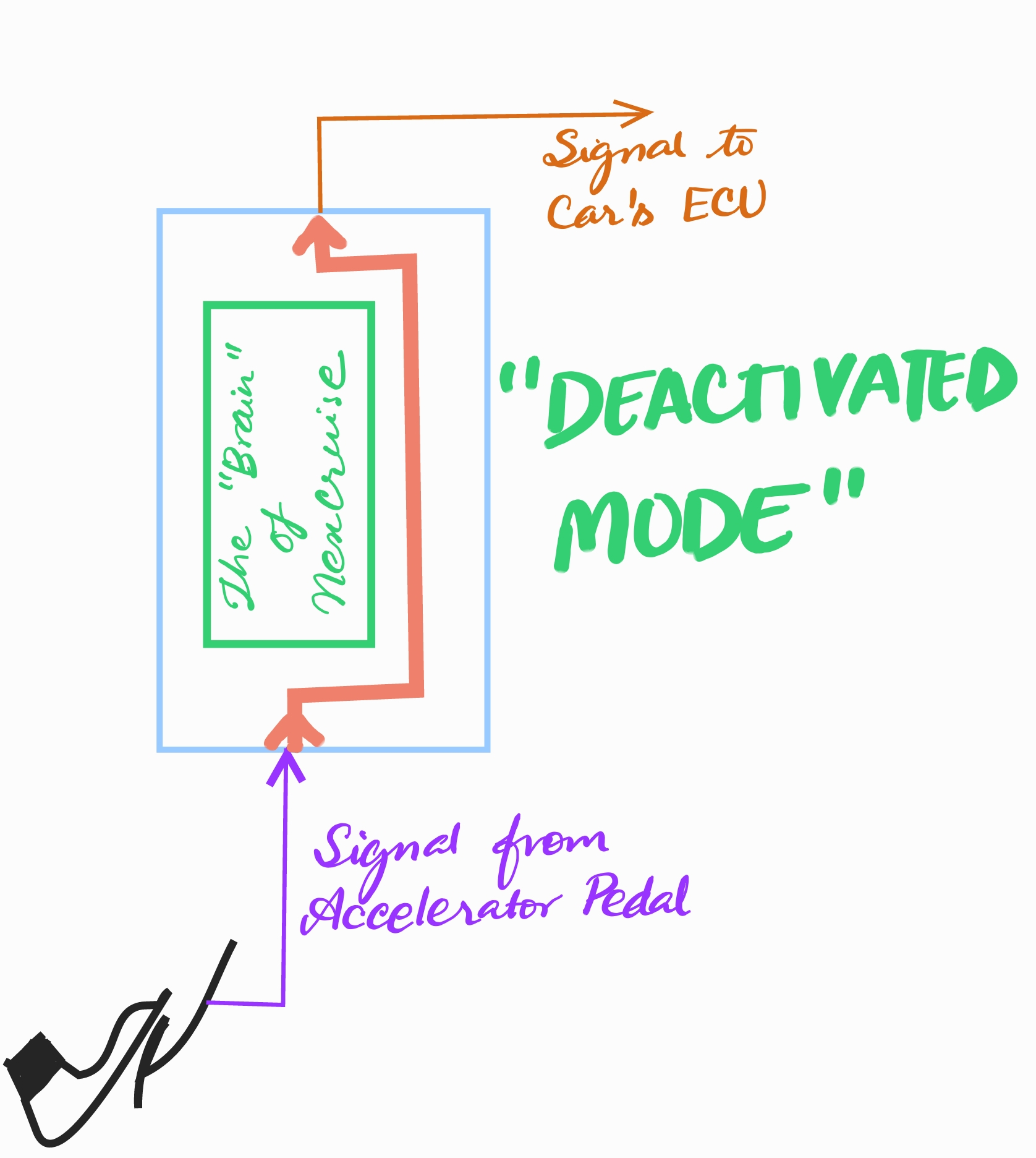

When, instead, it is bypassed using one of the methods explained later in this article, we call it "Deactivated".
When it is deactivated, the signal that originates from the A-pedal of your car directly goes to the car's ECU. It is exactly the same as how your car is without NexCruise.

This is how the NexCruise is working in normal operations
This is when the entire processing chain of NexCruise is bypassed: The A-pedal signal directly goes to car's ECU without any modification.

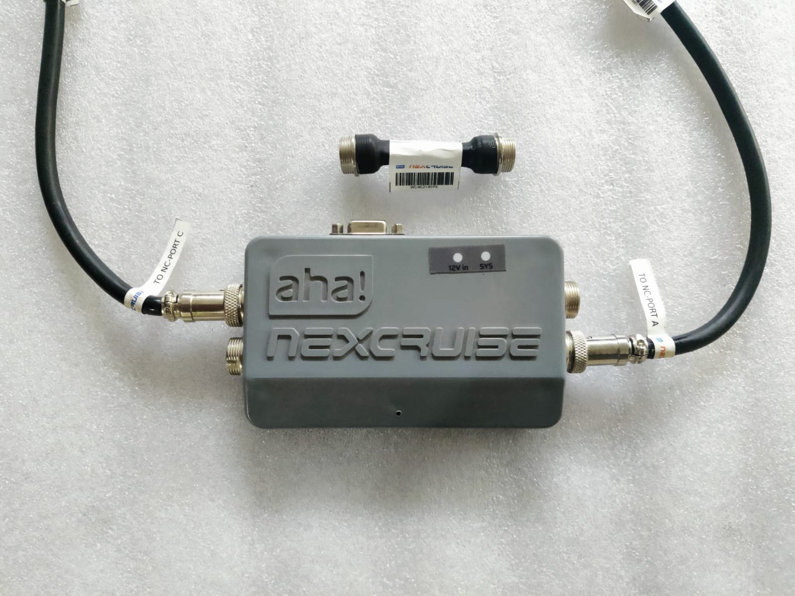

b) NexCruise without a deactivate button
In this case, your NexCruise will not have this button, but you will have received a "bypass connector". The NexCruise and the bypass connectors are shown in the photo below:
If your NexCruise resembles the photo above, to bypass the NexCruise, unscrew the Port A and Port C cables, and join them together using the bypass connector (the tiny jointer shown above the NexCruise main unit in the pic above).
Don't do any cable-related operation without first turning off your car, taking the key out and waiting for the car's electronics to turn off.
