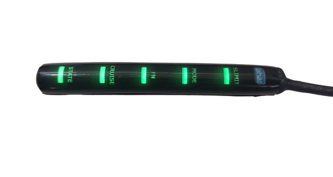

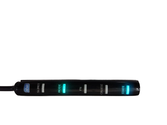

  2. Ensure the STATE LED on the NexCruise light bar is glowing.

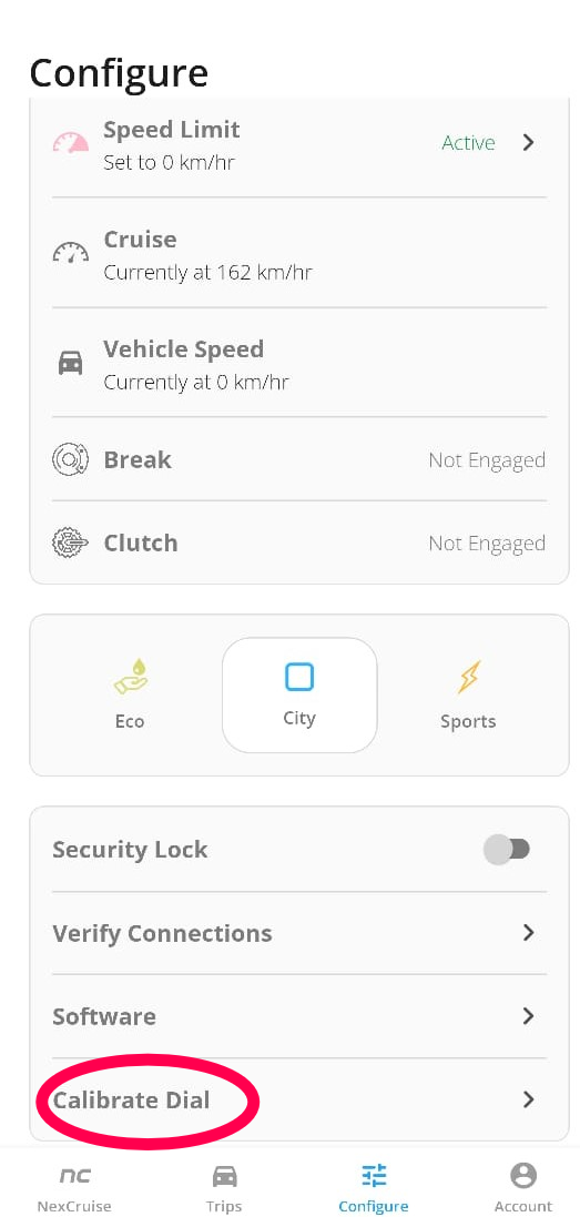

  2. Open the Car.Os app → Home Screen.
  3. The status should show: ✅ “Connected”.
  4. Go to the “Configure” tab in the app.

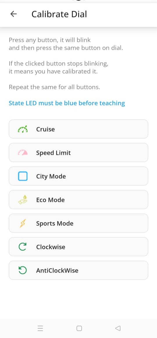

📲Press a Button in the App
  1. Tap any button in the app (e.g., Cruise, City Mode, etc.
  2. The LED Strip will start blinking.

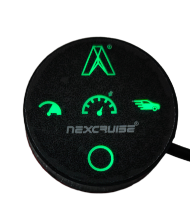

🎛️Press the Same Button on the Physical Dial
  1. When you press the same button on the actual dial,the blinking in the LED Strip will stop.
  2. This means the button is now calibrated.
Repeat for All Buttons
  1.  Do this for each button:
    Cruise, Speed Limit, City Mode, Eco Mode, Sports Mode, Clockwise, AntiClockwise.
