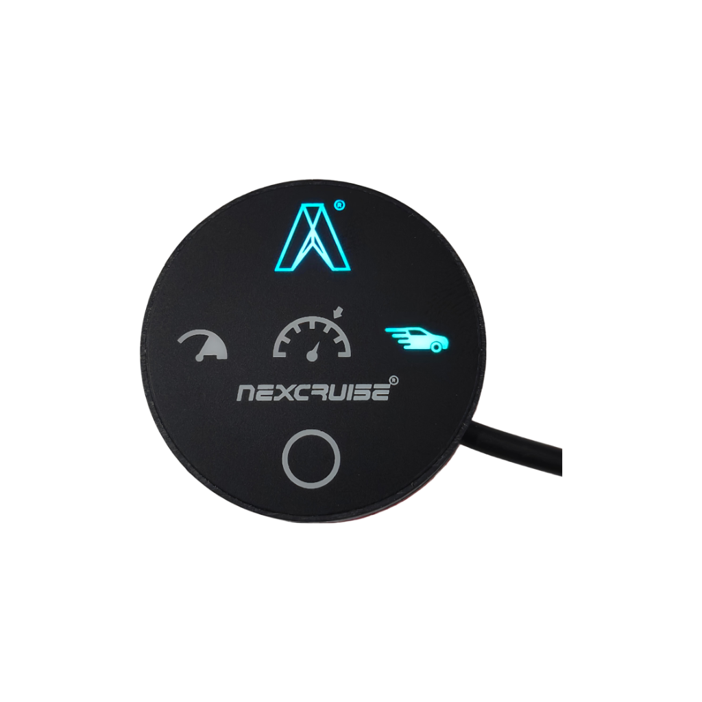

🚗Power the Vehicle in ACC Mode
  1. Turn the car to ACCESSORY mode (don’t start the engine).
  2. Ensure the STATE LED on the NexCruise light bar is glowing.

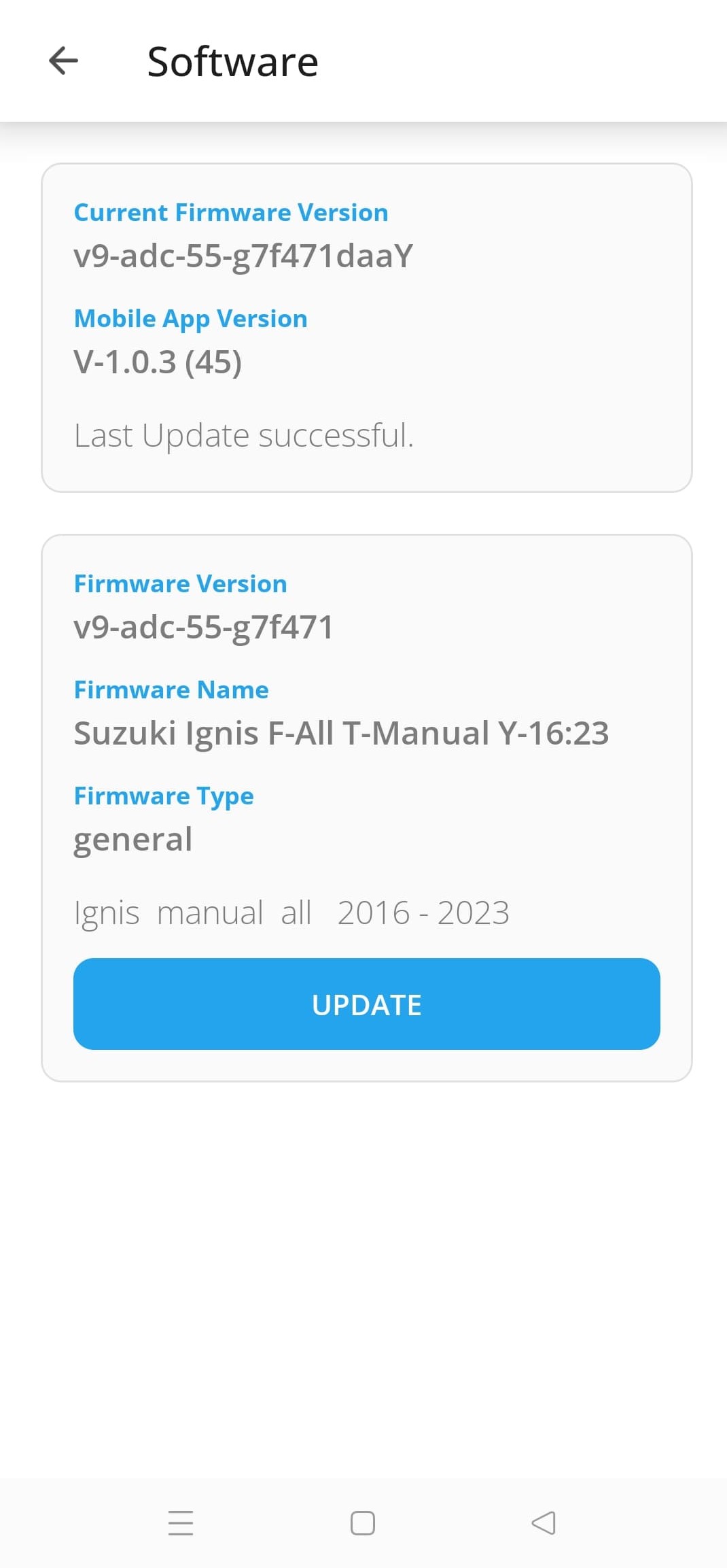

  1. Go to the “Configure” tab in the app.
  2. Tap on “Software”.
⏳Start OTA Firmware Update
  1. In the Car.Os app, tap “Update”.
  2. The “Download Firmware” screen will appear.
  3. Tap “Download Firmware” to begin.

🟢After Update
  1. Check the current software version to ensure it is the latest.
  2. If you see:"Last Update Successful".
