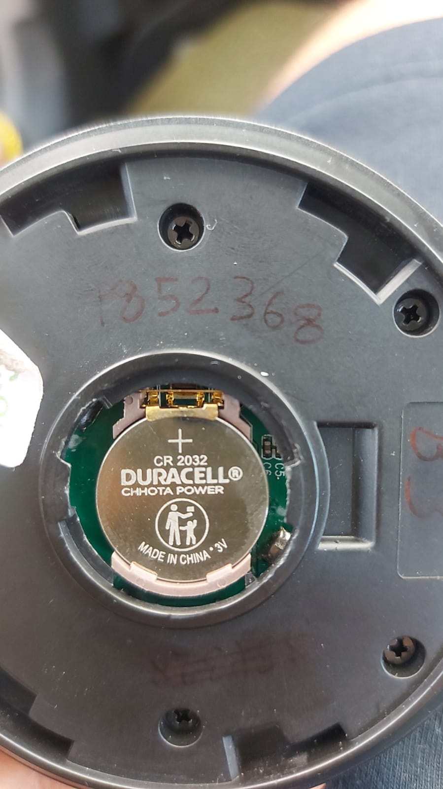

Normally, the NexCruise ships without the battery. Just insert the included battery inside the dial, and you should be good to go!
When you install the battery, it should look like this:
  1. While inserting the battery, ensure that it goes under the copper hook as shown in the pic above.
  2. The '+' of the battery must be facing us. Take care not to insert the battery upside-down.

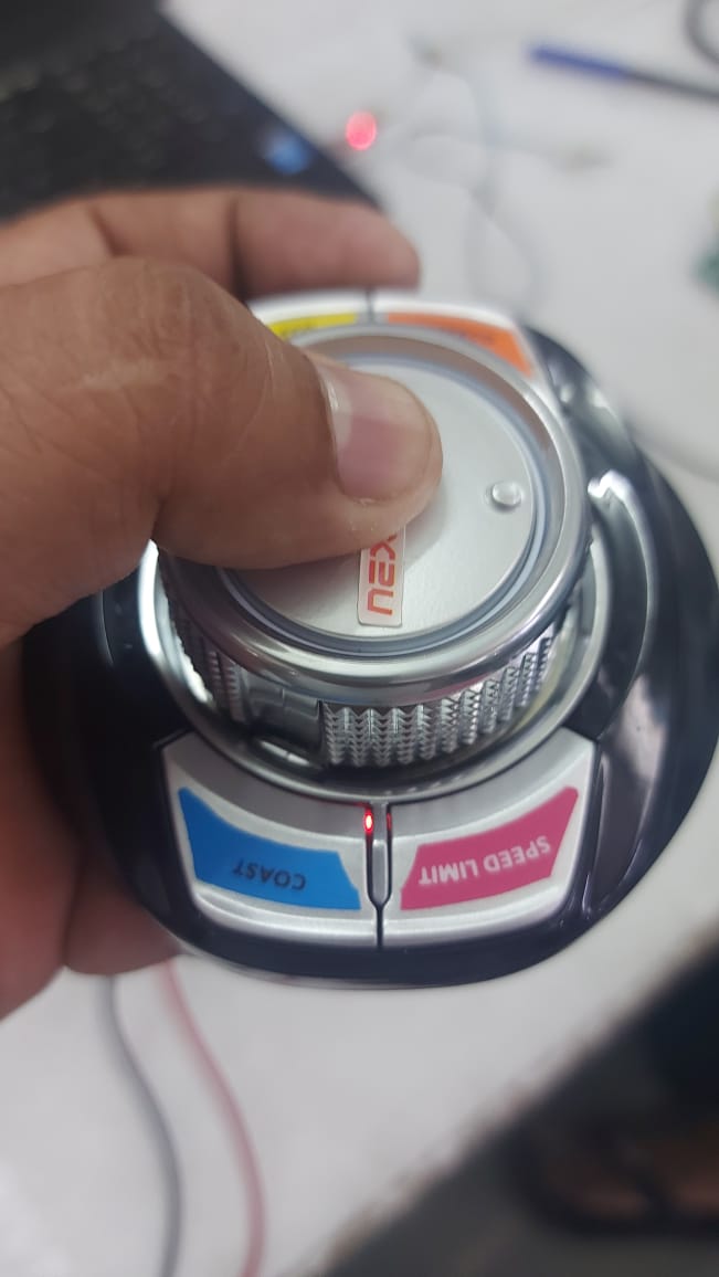

Check if the battery isn't gotten weak by the following method:
When you press and hold any button on the dial, you will see a red light emitting from the gap between Blue and Magenta buttons.
It should be glowing solid for as long as you press the button. And should turn off when button is released.
Solution
If it doesn't glow, or if it flickers, the battery needs to be replaced.

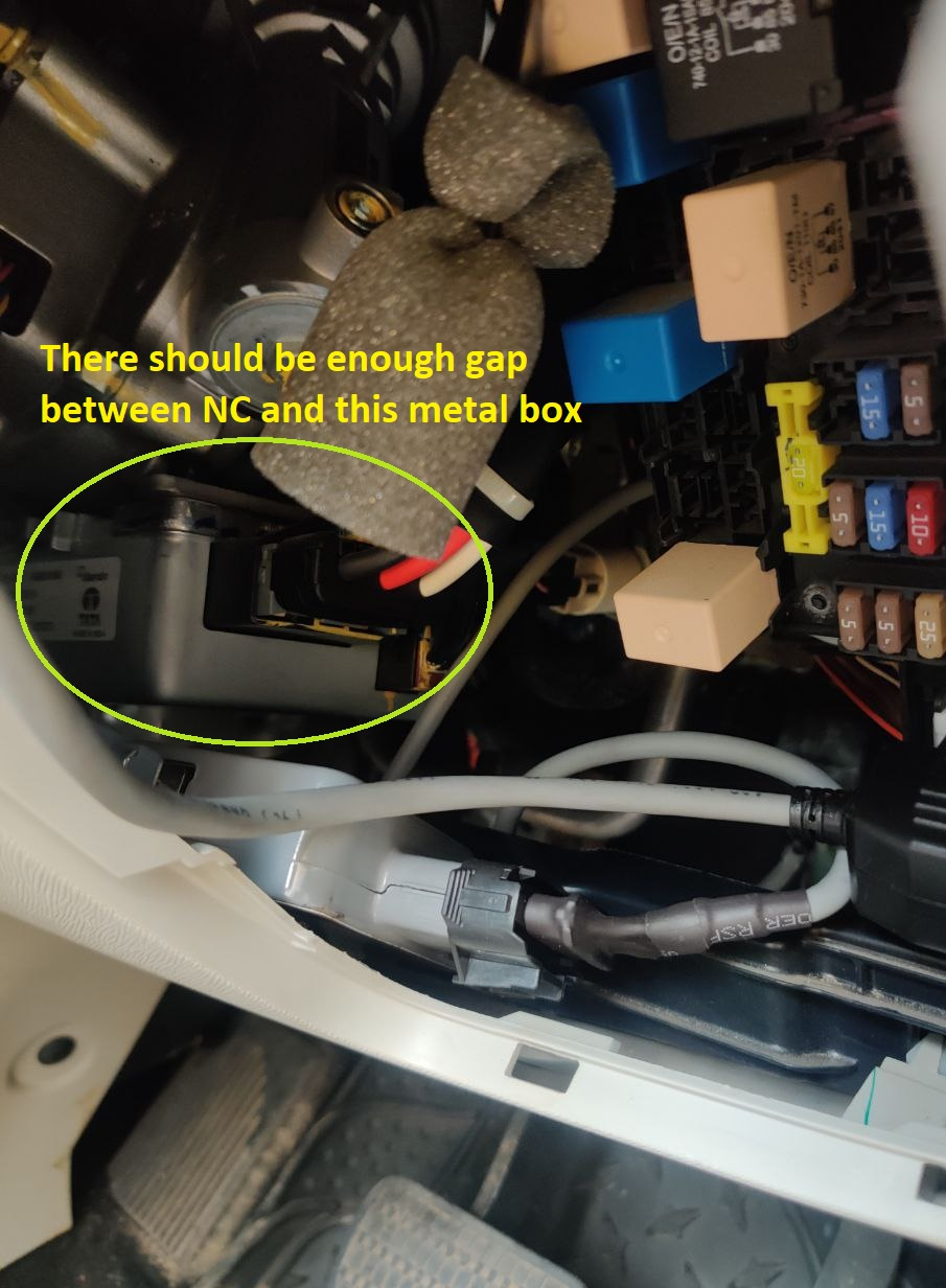

Sometimes, fixing the location of NexCruise does the trick.
The NexCruise main unit shouldn't be too close to any metal object. That interferes with the signal of the dial and and causes it to work improperly.
Solution
In Nexon EV, there is a metal box under the steering column. (note the one with red and white wires in the pic below) Ensure that there is atleast one inch gap between your NexCruise unit and this box. You can use some packing foam to make the gap if needed.
With the above remedies, your dial should start working in all probability. If not, please call us and we will help.
