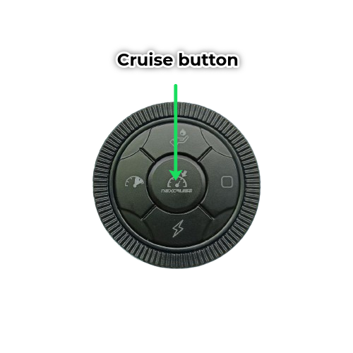

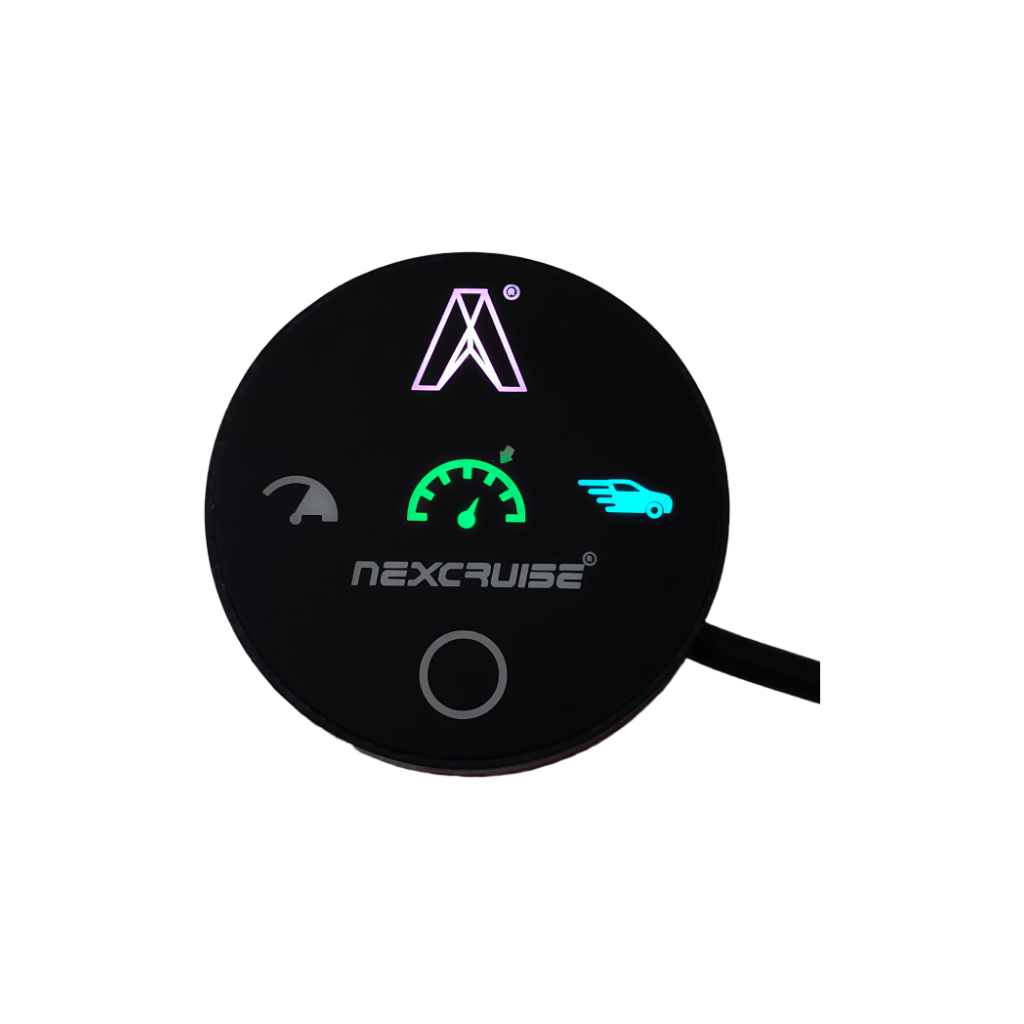

Check is the green LED glowing ( even for sometime ) when you press NexCruise.
Solution:

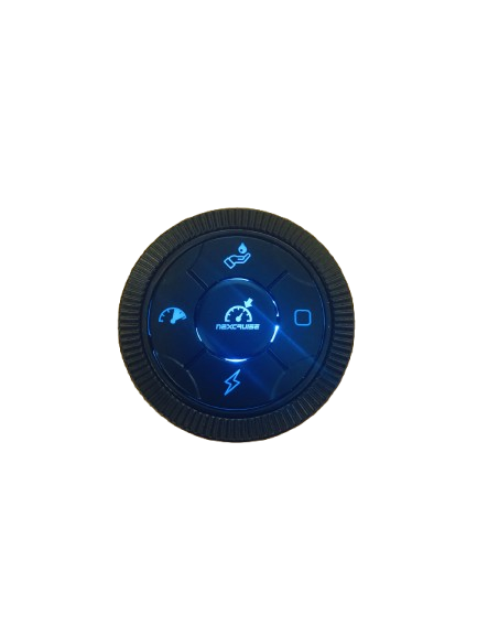

2. Dial Battery Discharged
Diagnose:
Check if the blue backlight glowing in the dial?   Is it already 4-5 month or more since you last changed your dial batteries? Or do you do a lot of dial driving?
Solution: Replace the batteries in the Dial.

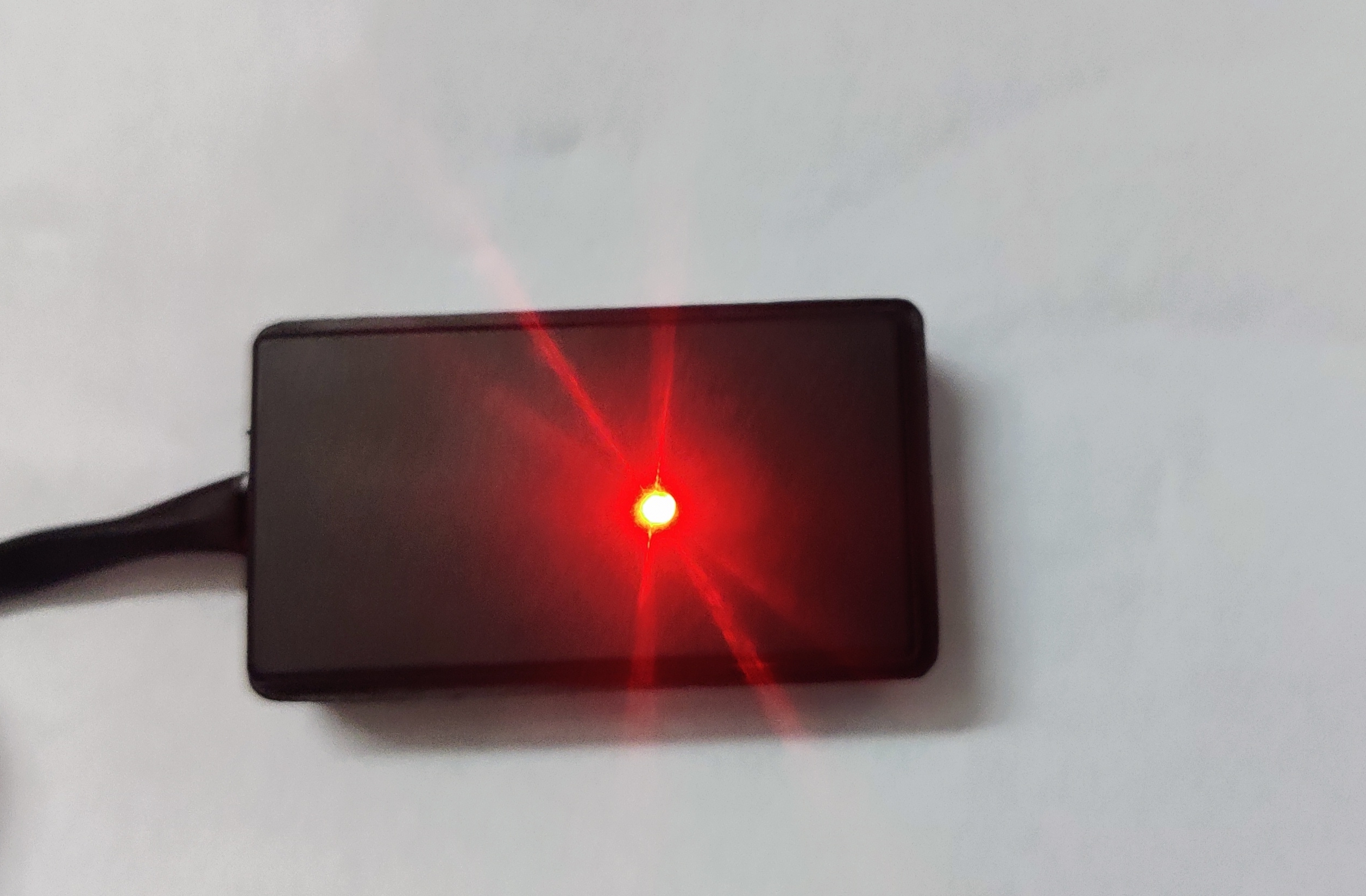

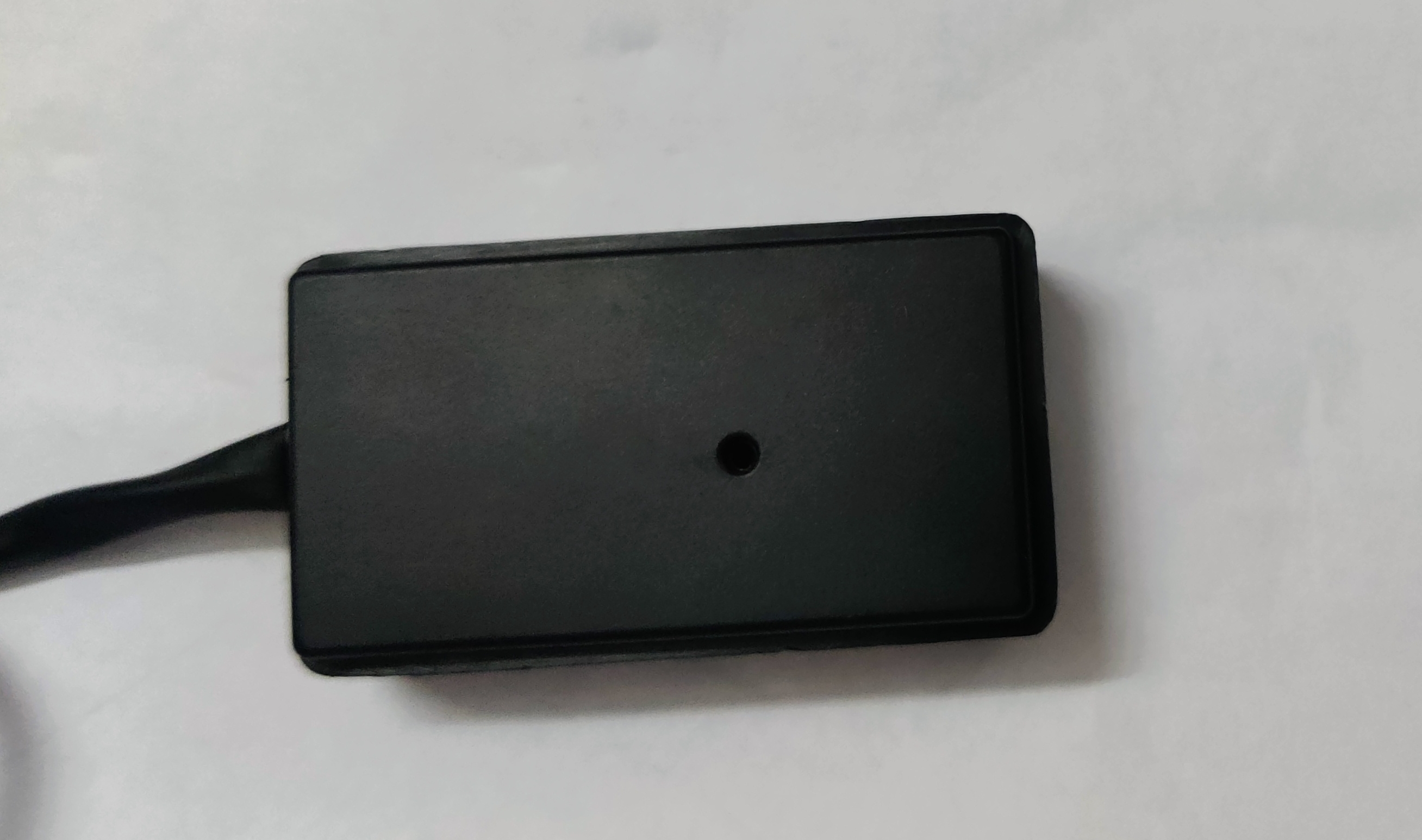

4. Receiver Faulty
diagnosis:
 if the dial is working properly then Check the RED LED inside the receiver module lights up:
                              Before Dial key press
                        After Dial key is pressed
Solution:
  1. If Red LED doesn't glow after pressing Dial button then it mean the receiver can be faulty, in this case replace the receiver.
  2. If its working properly then check the next issue.

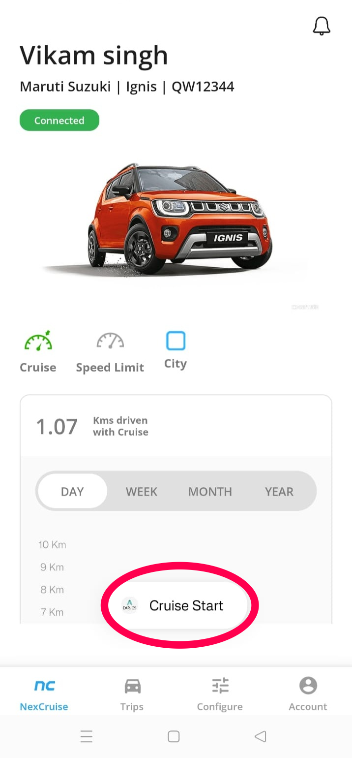

5. Dial key connectivity with Car.Os app
Diagnosis: Ensure that dial key is received by Car app.
  1. Open Car.Os app.
  2. Press Dial Key
  3. Ensure that you  popup message as soon as you press the key
Solution: If the popup message is received in Car.Os app than it means Dial is connected to the app.then check the next issue.

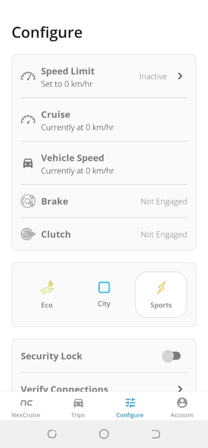

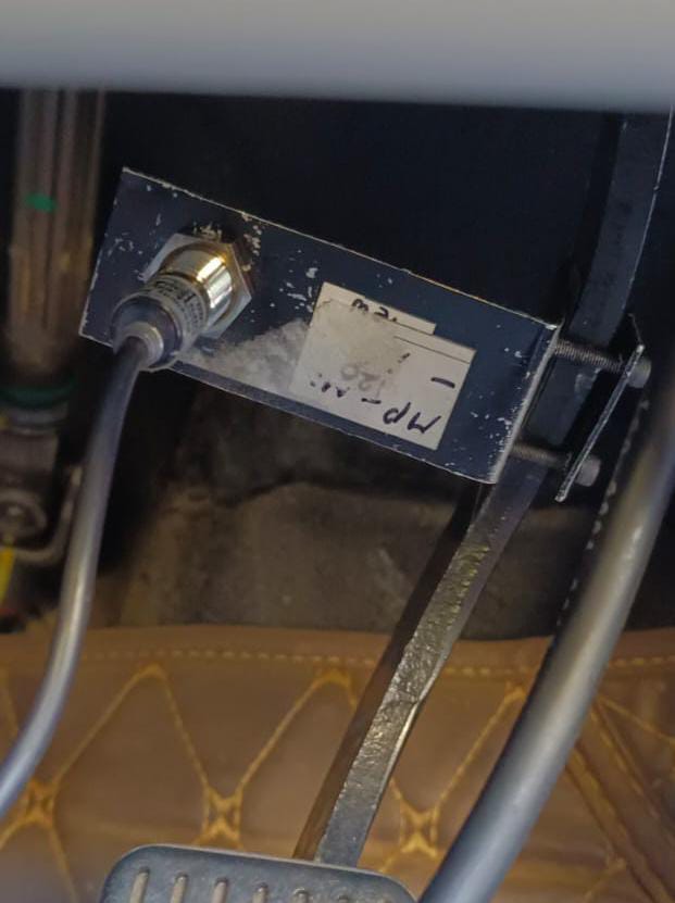

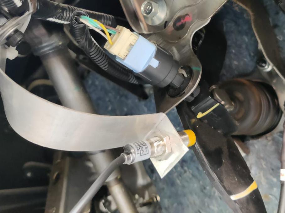

7. Brake sensor not mounted properly
 Diagnosis: If the brake sensor dislocates from its position, as a safety mechanism, Cruise doesn't engage. Ensure that the brake sensor is mounted correctly. To ensure check weather the brake sensor is touching the metal of brake pedal or not.
                         Not Mounted properly
We can also check this in the Car.Os app, The Brake Engaged come when the brake pedal is not pressed.
Solution:
Mount the Brake sensor properly in a way that its connecting to the metal of the Brake Pedal.
                                     Mounted Correctly
Check weather the Brake Engaged is coming when we press the brake pedal in Car.Os app.
                Before Brake press                                                                            After Brake is pressed
If the show Brake Engaged is coming when the brake pedal is pressed then it means the Brake sensor is working properly.
